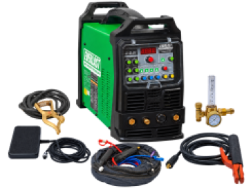

PowerTIG 250EX Water Cooler Package
This combination package includes the PowerTIG 250EX and PowerCool 401 Water Cooler, designed to pair together as an integrated system.
The PowerTIG 250EX stacks securely on top of the PowerCool 401 using a system of slide-on interlocking tabs. For a more permanent installation, the two units can also be fastened together using the side-panel screws and bracket, keeping them firmly connected during use and transport.
The 240V PowerCool 401 plugs directly into a dedicated power outlet on the rear of the PowerTIG 250EX, providing a clean and convenient installation without the need for a separate 240V wall outlet.
This package also includes all of the standard accessories supplied with the PowerTIG 250EX.
