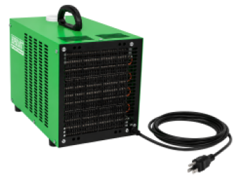

PowerCool W350 (120V)
Product Overview
SKU# PCW350-120
- Unit Weight: 35 lb
- Unit Dimensions: 10 in × 18 in × 14 in
The 120V PowerCool W350 is designed to work with non-Everlast welders and torches and is an affordable alternative to more expensive 120V brand coolers from other brands. These affordable coolers are a solid, reliable cooler cooler choice with copper core heat exchanger (radiator), stainless steel pumps with a brass impeller, and 5/8 LH standard compression cooler fittings that can fit most standard brand torches natively. The cooler comes with the left hand adapters included so it can be adapted to fit any torch. The cooler's flow rate is at a standard 1.1 liters per minute. With a two gallon capacity resevoir combined with the large heat exchanger, the welder can be used to cool torches up to 350A. A heavy duty pump and sealed industrial motor (made in Italy) are at the heart of the unit and designed for long life service. The beltless design puts the pump, fan and motor on a single shaft to improve reliability and reduce maintenance. There are no belts or pulleys to replace.
