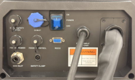

The new Red Sabre 2000 is a 2000 Watt, air cooled portable laser welder designed for compact size and portability. The air cooled design of the RedSabre is new and innovative way to cool lasers without heavy, large water cooling systems. Many Fiber lasers in this wattage range are heavy water-cooled lasers weighing 600 lbs or more. The high volume fan and high temperature diode design of the RedSabre 2000 reduces the foot print of the welder. The ergonomic SUP33T gun design and safety features are hallmarks of the RedSabre model line. This model can Weld, Cut, and descale rust and paint.
Includes detachable touch screen color LCD controls and synchronizing wire feeder.
For Manual use only. Not intended for automatic or computer controlled applications.
