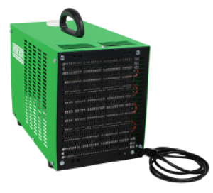

PowerCool W300 (240V)
The 240V PowerCool W300 is designed to work with any older Everlast unit with the triangular plug connection (IEC 60320-1 C-13) located at the rear of the unit. It is recommended for up to 350A welding. However, the PowerCool W300 does not stack or or integrate with the welder physically. The unit must be placed beside the welder or be installed on a separate shelf over or under the welder. The unit features standard B Type-9mm color-coded quick connect couplings that can be used directly with any Everlast water-cooled TIG or MIG torch without any need for adapters. Also included are water-cooler line extensions. These are there if you need extra length to be added to the torch so that a strain free connection can be made if the water-cooler has to be installed in a separate location. The audible and flashing cooler alarm helps to alert users if a torch line becomes kinked or blocked, or even if the unit looses proper circuilation. In the case of some low-flow torches that may trigger the cooler alarm, the cooler alarm can be de-armed (turned-off). The unit features a copper core heat exchanger, Italian industrial sealed motor and Italian stainless pump with bronze impeller that are designed for years of use. Many competitors use all aluminum piping for heat exchangers and low quality motors and pumps in comparison. This unit features direct shaft drive of fan, pump and motor. There are no belts, or pulleys to wear out or replace.
